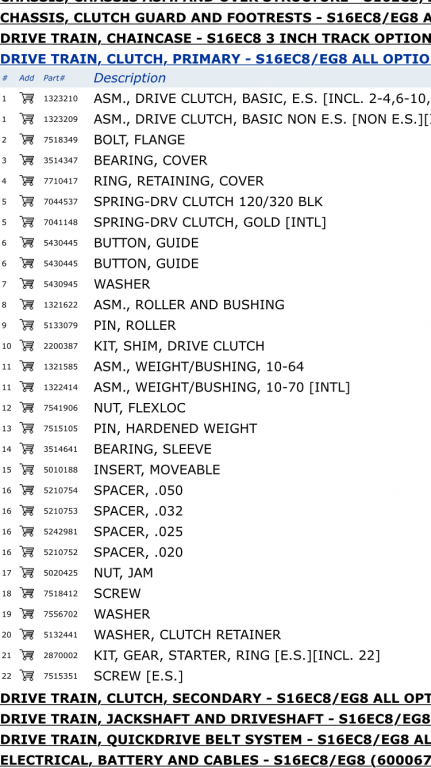

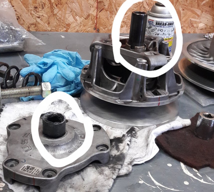

Anyone ever change or replaced the bearing locates on the primary clutch cover. It's a fiber material. I was cleaning my clutch and thought it was a metal piece with a bunch of build up on it and used a scotch pad and tore the shit out of it. All other sleds are some form of metal. I removed it and ordered what I thought was the right one from dealer according to the parts guide but it is not. Any help please.
Boom that's it. What parts look up are you using? I already ordered aftermarket one because I need it and couldn't find correct one at dealer
Be careful installing that bushing I've seen guys wreck the new ones putting them in.
Google polaris browse for part numbers
As lid said. Be careful installing.
I made a puller years ago for these bushings . Polaris dealers have the tool too.
Or perhaps have a dealer push one in. They are easily messed up.
