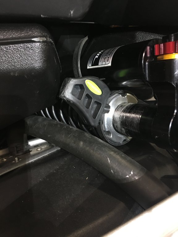

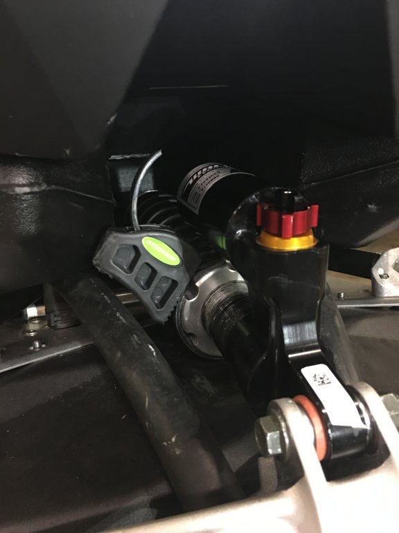

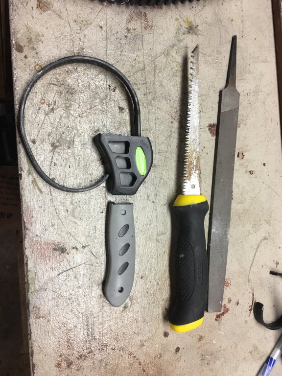

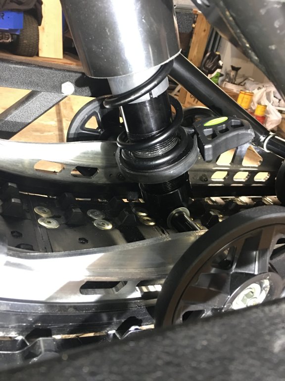

Wanted to put this out there for all the members. It’s a tight squeeze to get my hands in on shock and i wanted a lightweight tool to assist me in turning it if needed. This is what I came Up with.
A 4.99 strap wrench from Harbor freight. Lightweight And small.
The drywall saw was quick and handy
Works great in garage. I will have to see on trail

That will be the test for sure . Heading to Vilas Co tomorrow night thru Maybe trailer to Watersmeet .
Yeah I have the sport bag and that frame leaves no room to adjust on a Rush. Not sure this would work but it's a cheap investment to try!
