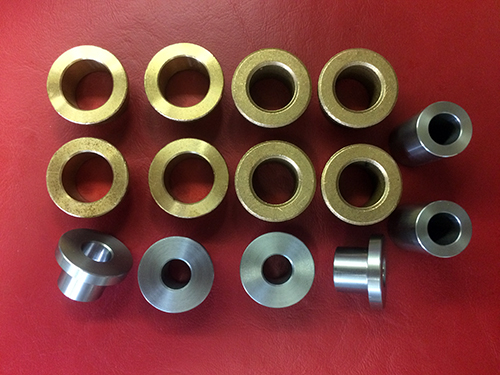

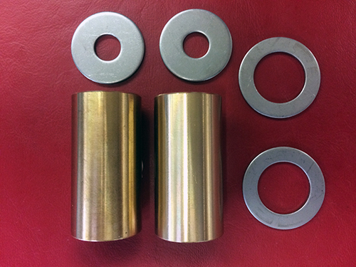

Remove the mount bolts that go through the rail where the rear crank pivots then the 2 up front. Simple as it could be. Check the bushings... someone on here sells upgraded ones.

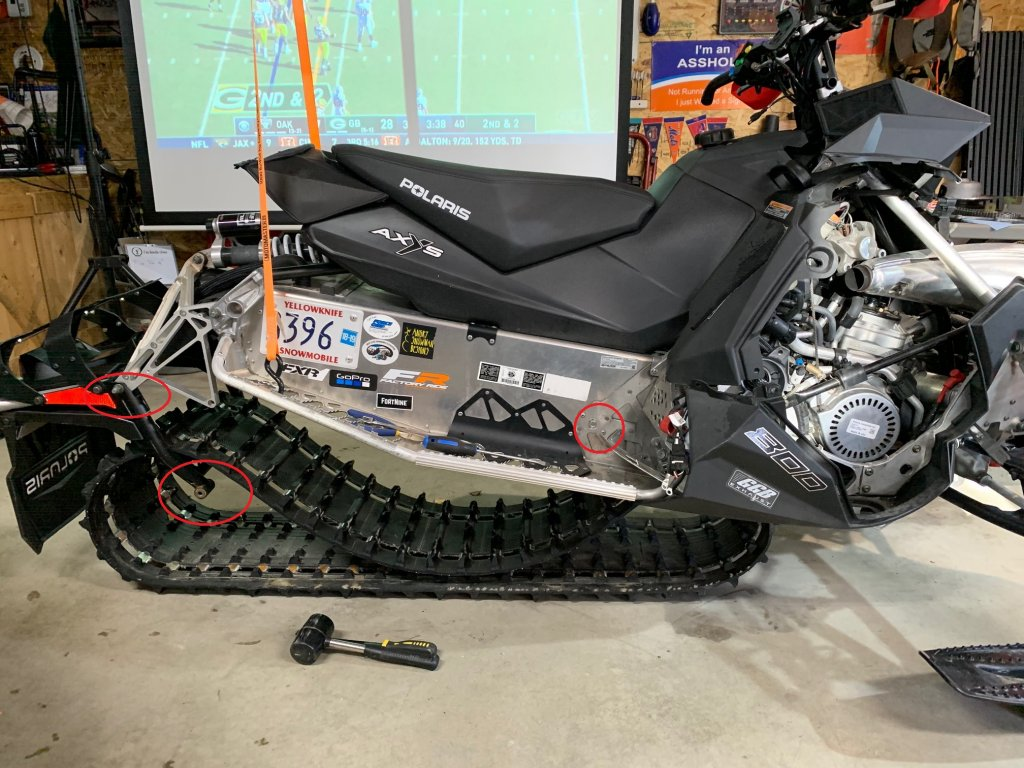

Pulling my skid, seems one bit of advice would be that you shouldn't try to lift the rear of the sled from the rear bumper, (as you would on most other style sleds) because of that odd flex point pulling up on the rear bumper moves/put pressure on the attachment point of the two bolts that mount to the skid in the rear.
I think it's best to lift from a more forward position to avoid that flex point, should make it easier. (similar to what's shown below).
