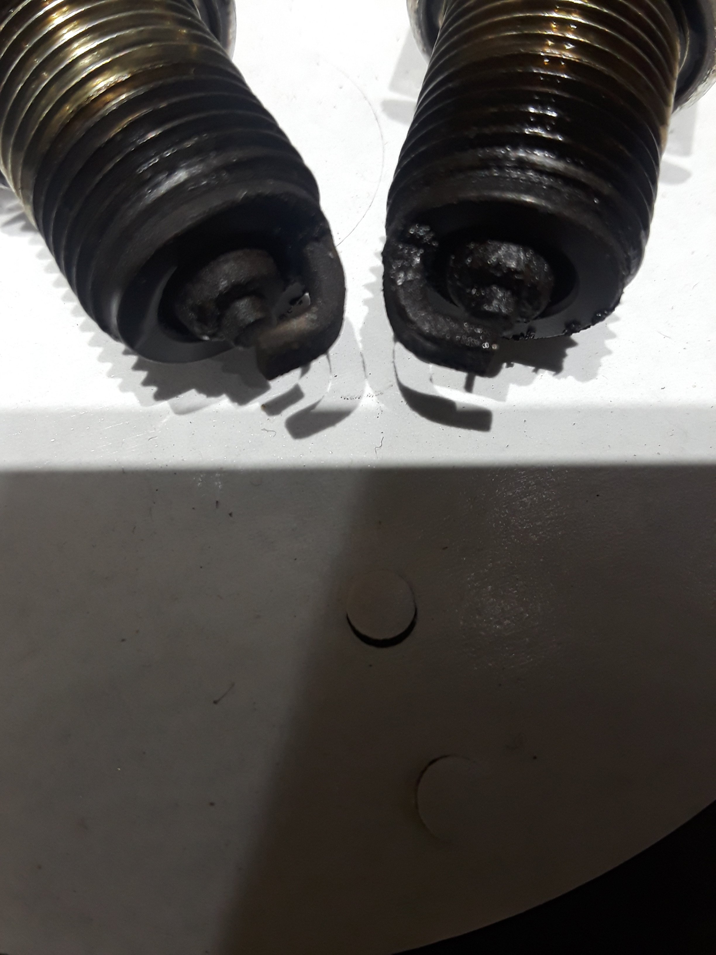

Just got back from U.P. Michigan sled trip. Sled ran great. I replaced the motor about 1800 miles ago with a REV6 long block. Original motor had 7000 miles on it and I was concerned with possible crank failure issues. I turned up oil pump adjustment just a little bit from stock. I have about 1600 miles on it now. Of course I would like to get better fuel mileage, but not a deal breaker. Sick of hearing my friends with E-Tech's brag about their MPG. I lost about 2 MPG after overhaul, got about 12.5 mpg on a 1060 miles trip this time out. Here are pictures of my plugs taken out today. I would appreciate any feedback. Don

Definitely running a bit rich. Given the age and mileage, I would start with running some injector cleaner mixed in the gas, they are probably a little dirty. I would also consider getting a set of VForce 3R reeds. I replaced the ones in my 13 and the stock ones were nothing great, known to be a little weak. Woke the motor up a little too.
