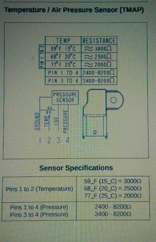

#1is actually were #4 is. #2 is actually were #3 is . The pic showing is upside down.
#4black= ground
#3pink=to 26 pin connector
#2 red/wht=sensor power splice
#1 grey=to 26 pin.

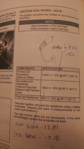

Secondary coil resistance without plug cap , black to high tension lead should be. 13k ohms.
plug cap resistance is5k ohms

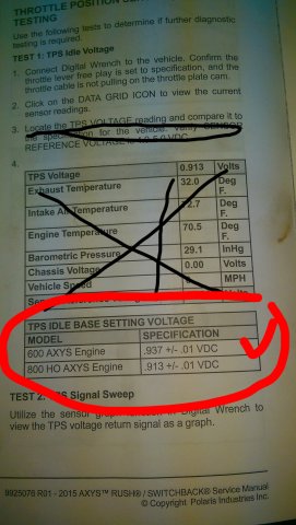

We're I scratched out, that's from factory as an example only.
Just worry about what I circled in red
