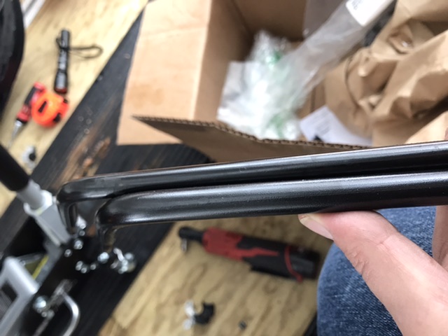

If your having ski lift issues in our tight Wisconsin trails I would suggest changing the sway bar. Once again the XCR is made for hauling ass over bumpy terrain so the sway bar has a much smaller diameter than the the trail oriented pro-s.
On both of mine I have changed the sway bar, replaced the front ski springs and replaced the FTS spring. In reality I should have bought pro-s sleds and just swapped the front track shock with the hi/lo shock because it’s the one thing that really works great on any axys chassis.
