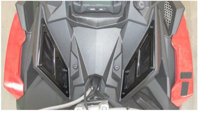

Anyone running this kit with a stock motor and oem mapping, possibly someones pipe? Can more air help a non ported motor?
Dave, I just installed these vents on my '16. The final result is that it looks damn near stock! I went this route since I'm running the Jaws pipe. More air = more HP. And these 800 HO's need it. I suppose on a stock exhaust, stock motor machine, it's not that critical and may not be worth the time to install.
