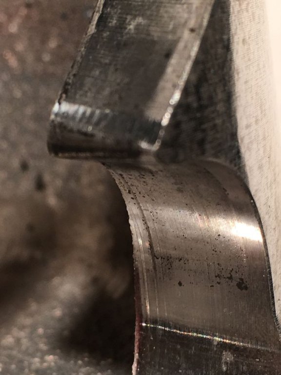

I'm redoing my clutching using all the great info here.
I have found a questionable wear mark on the factory helix and want to make sure I fix the problem when my new one comes in (50/44 F)
There is wear a divot you can see and feel just past the ER notch. in first pic.
What could cause this? it is on the backshift side of the helix.

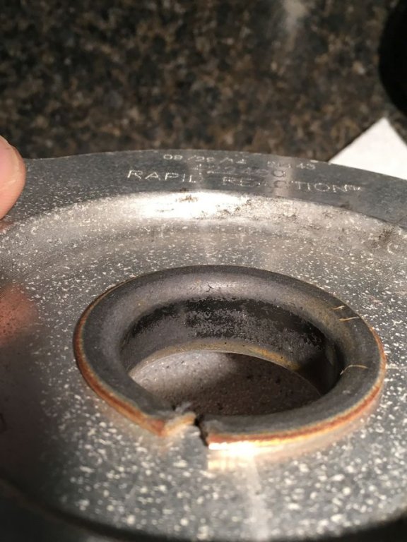

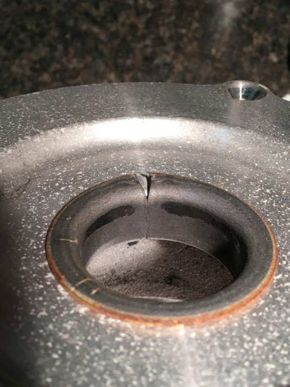

Do the bushing pictures look like it has been binding?
Hard to tell from the first photo, but I'm thinking it was machined there because I can see machining marks in the trac.
The cover bushing looks normal to me.
