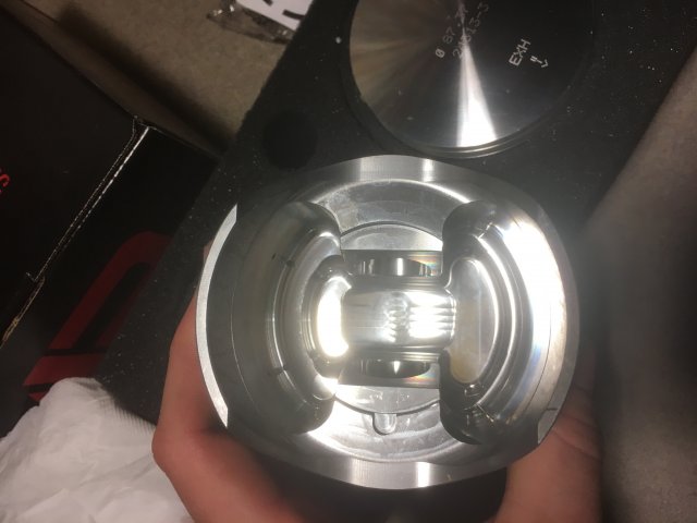

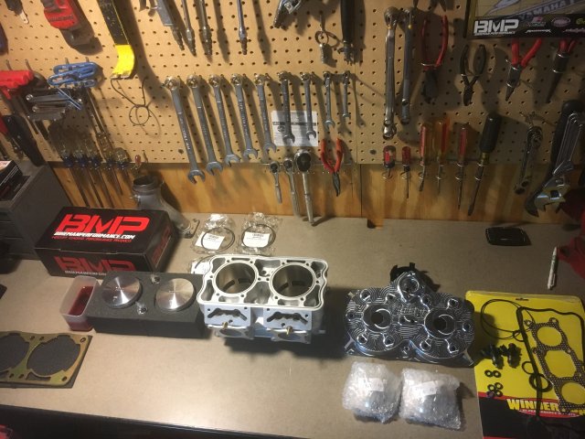

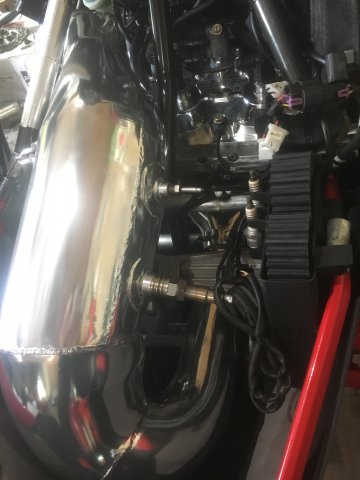

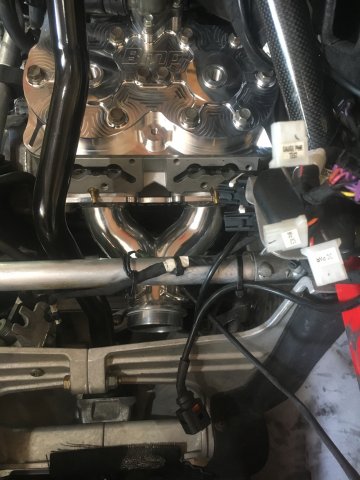

Went with the Bikeman big bore kit. The pistons are definitely nice looking. i am going to be really testing this motor next year for power and reliability as I plan to put a lot of miles on it. Already got it together and started. It feels faster reving from the lighter parts and more responsive from the little bit I reeved it up.

I actually just bought a big bore cylinder they already had on the shelf. I'm keeping mine to try doing some wild stuff over the next year. I didn't do anything with the bottom end just from how good the top end looked and speced when I took it apart. I did new wrist bearings tho.

If pistons are big enough size they will smack the bottom top case. Ya I had to get my powervalves cut to match piston size

The total pistons weight of this bb is less than Polaris stock pistons which is a good thing. I'm interested to see how it holds up as well .
