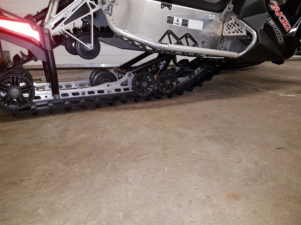

Your post sounds all to much like what I went through, fix one thing but upset another. Thought I'd hit on something I liked several times only to have snow conditions change and the sweet spot not feel so sweet. When sled was in the dealer for crank seals over the summer, service guy asked whats up with how high I have the FTS cranked up, said it looked closer to what you'd expect from a Pro X.
