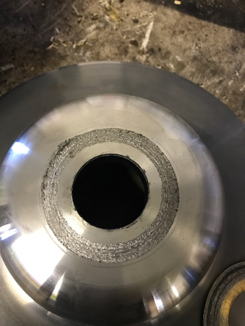

Common yes, but not normal. The bolt that sets belt deflection is ripping the groove in the sheave. I would put a steel washer in between the sheaves and let the bolt contact that, not the soft aluminum. The next time I have a secondary apart, I'll check for possible fixes.
How many miles are on the sled?
Sled has 1800 miles. The washer has a pretty good groove from the deflection bolt. I ordered a new washer and am going to emery cloth the sheave to make it through the rest of year.
