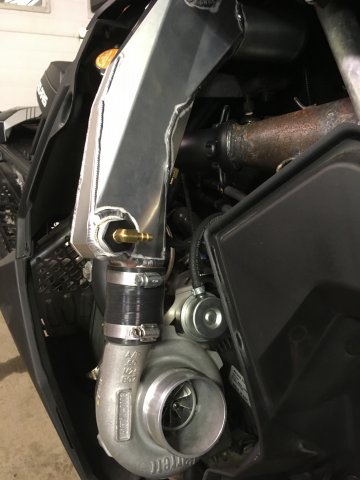

It's not a rush or a switch, but the concept is the same. May have to modify the air intake, the steering on an sks is different.

View attachment 1931 It's not a rush or a switch, but the concept is the same. May have to modify the air intake, the steering on an sks is different.
