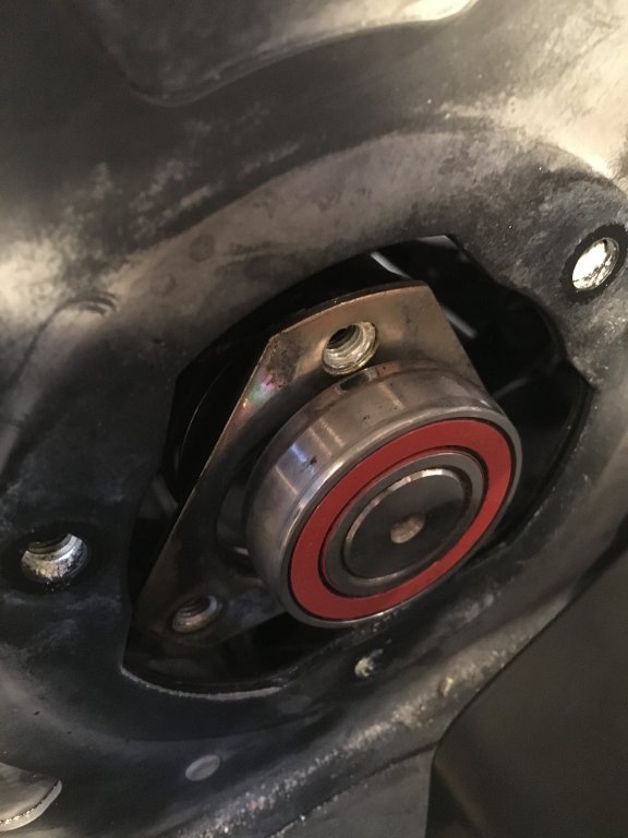

Chain is tensioned to spec, we did spin the track and the driveshaft looks good visually, drive cogs are worn from the studs but otherwise not damaged, rear axle is out for replacement of idlers so track completely loose and upper idlers spin smooth and appear round, photo of clutch side drive bearing here and it looks new and spins smooth, no water in cup, motor mounts do not appear worn much if at all, cannot get the primary bolt to break free and afraid of clutch damage so have delayed the ring gear bolt inspection, new wheels/ bearings in later this week and I hope that fixes the vibration . . . No snow here to allow test. Might snow check an Indy 129 850, dealer is on board.

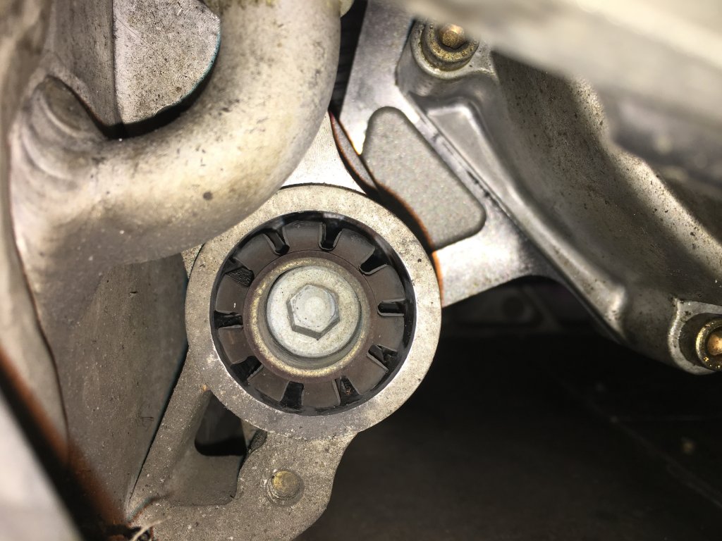

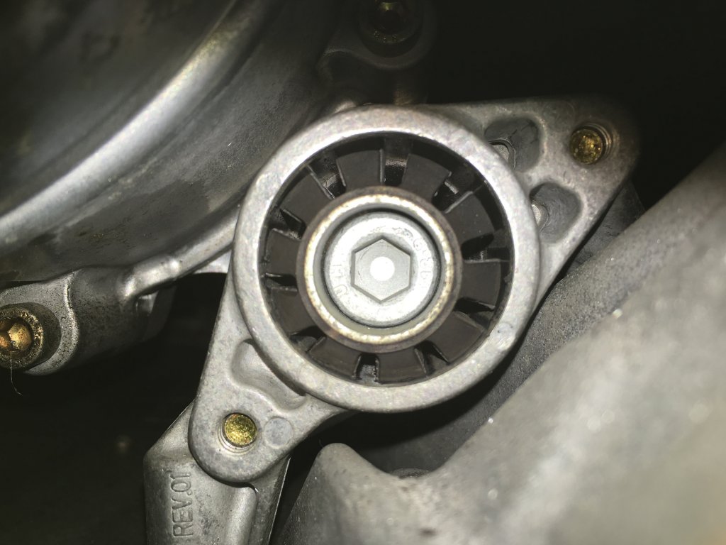

see photos of mag side motor mounts, I do get some movement when levering the motor. Good or bad or just replace since I am here?
Thanks!
ZRsledhead - Opened up the chaincase and you were right on the tension, way too loose compared to what you would expect to spec. It appears there is a washer with rubber inner seal “in front” of the lock washer, this washer causes the feel of the “finger right” to be distorted, clear when cover is off. I might suggest that Axys owners back off the locknut and washer so that it does not interfere with the feel when tensioning chain to finger tight and backing off 1/4 turn. Any comments on this? Am I correct or is this washer in place to avoid over tightening?
Sounds like what I found on my own, sorta po'd I'd missed it and had the chain way too loose. Yes need to back them well off n maybe squirt the threads with a little lube to get a better feel of exact where your at.
Agreed, I will replace as I have access now? Looks like Polaris has upgraded the part nums for 16 to match 18 XCR. I understand the mag side goes and can cause belt issues? Any tips on getting the silencer back in and springs on?
A long-ish T style spring tool and some patience makes it very straight forward. Worst one is the rear inside, mines been off twice now, no split or bleeding fingers.
Anything that cuts down on blood n swearing is money well spent.
