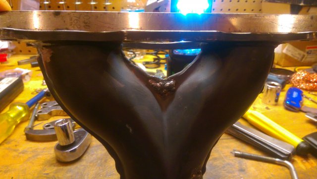

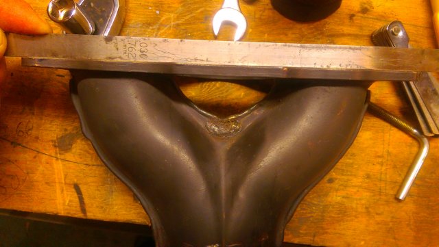

The y pipe wasn't flat from factory due to weld distortion I believe. Over 0.045" out. I know the gasket is 0.075" thick, but I like flat. This one was leeking and it also had 2 small hair line cracks.
Apparently there are more of these out there according to dealers I've talked too.
Just an observation.

My O2 800 XC XP had a mysterious oil leak under the y-pipe. it was warped big time. I laid sandpaper on a piece of glass (the only really flat surface I could find on a weekend). Took my time and was able to sand it under 0.005". Close enough for me. New gaskets and it never leaked for the rest of the time I owned it. Same deal on my '05 500 XC XP. Same fix and it never leaked again. Since then anytime I have a y-pipe off out comes the sandpaper and glass. It's hard to believe how warped these things can get. Are they like that from day one or do they warp that bad from heating/ cooling cycles??

X3. Been there done that on a couple 600 ves, 700 ves, and you want to talk about a bitch, 87 Indy 600 triple. We drilled holes in the welders table at work. Tightened the ends down finger tight, heated it up in the middle and tightend them slowly, till flat. Then heated the whole base cherry red. Poured oil all over it till cooled. Smoke like crazy.The boss was off that day.

I massaged mine with a vice, torches and a ball peen hammer,lol
