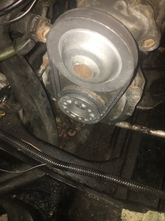

32C8117C-5794-4325-8894-4917A4EC4567.jpeg Hi there, recently I’ve been working on changing out the stator in my 1995 Indy 500. I’ve gotten almost to it but can’t seem to get the flywheel off, any ideas on how to do it?
Thank you, I’ve been trying to get it off but couldn’t seem too.
You can get a flywheel/pulley puller at Harbor Freight. Hit it with and impact and it should pop off after the center bolts out.
