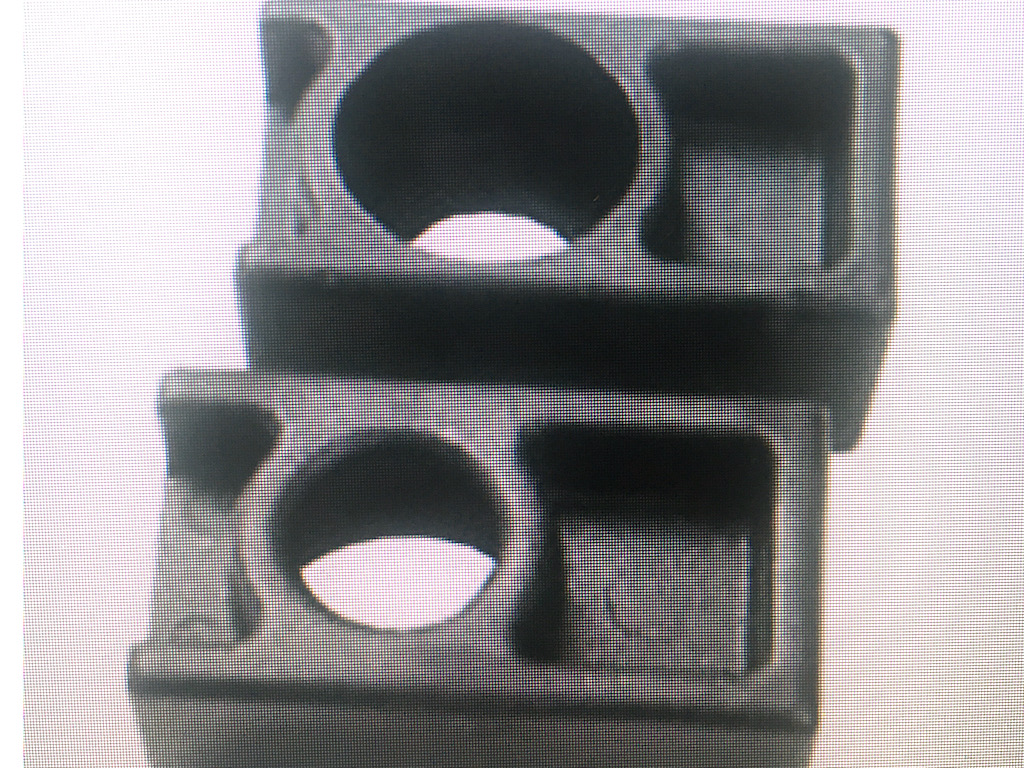

Mine are MIA. Bought new ones and unsure which way to install; hole is offset to one side in block and hole is tapered.
install into trailing area channel with hole to front or rear? which way should taper go?

Reduce image to 1024x768 with an app on your phone and it will upload. Also have you looked at any Parts Breakdown sites? Micro-Fiche with exploded view may help.
Been to dealers and have service manual but seems to be a “put it back in the way it was” item.

I think they only go in one way.. once the sway bar is connected.
I contacted Polaris directly; they go large hole opening towards engine and hole closer to rear; more material to front. The will fit flipped end to end or side to side (4 different ways) and will break if installed backwards they said.
