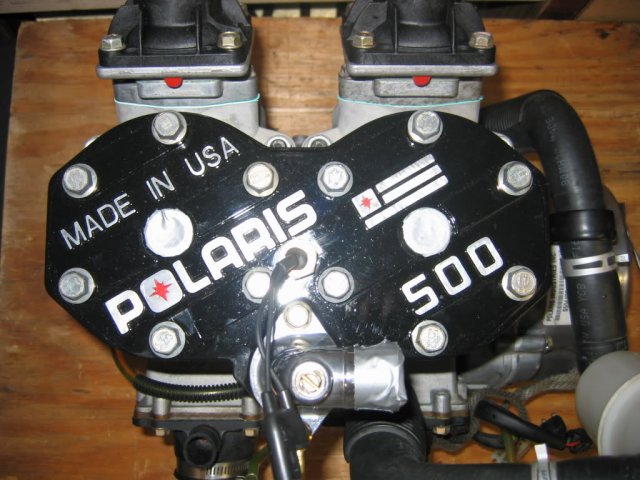

The 700 is completely different. Nothing will interchange. The 500 ves and 600 ves motors use the same case and crank. You can put 600 cylinders, ves valves, pistons,head/head cover on your bottom end. The actual valve blocks are the same between motors with the actual valves being different. A complete set of 600 carbs would also help, but the carb bodies are the same. both 38 mm. You could buy all the appropriate jets,slides,needles,nozzles etc for your carbs and change those internals, but a used set of 600 setup carbs would probably be cheaper. Over the years there have been different pipes used on these motors. You 500 pipe will work fine, if a 600 pipe is easily and cheaply found go that route. The Y pipes are the same. The timing curve is different, as is the actual base timing.. You will need the 600 cdi box. Clutching changes will be needed. A well tuned 500ves will run within 3-5 mph on topend of what a 600ves will run. Think about that. I did several of these change overs years ago. Pretty simple. Below is one I did. A little dremel work on the 6 makes it look like the 500 . You have to really now what your looking at to catch that.
