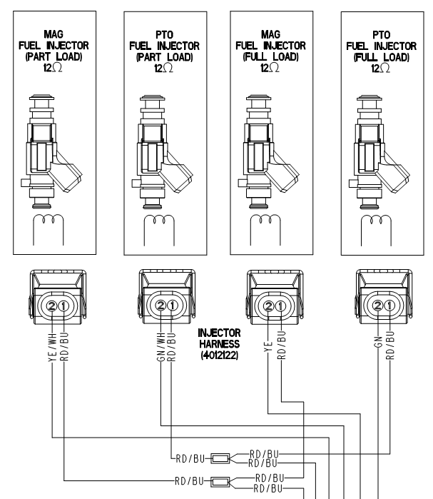

Hi I just did a rebuild on a 2010 Polaris rush 600 , when I marked the fuel injectors I only marked them mag and pto side and never marked what injectors were for the crank case and cylinders in the service book it says that the cfi 2+2 uses two part load and two full load injectors , but I can’t find anywhere if the full load injectors are for the crank case or the cylinders can anyone help me out here thanks

Hope the position in the wiring harness helps, see below. The parts diagrams show the orientation of the harness to the fuel rail.
