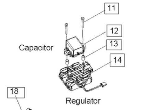

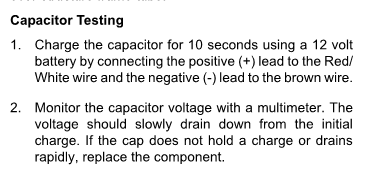

First thing I would look at on the sled is there is a capacitor piggyback mounted to the top of the voltage regulator. I would start by checking that, unfortunately the procedure from Polaris is pretty vague.
Below is from the Pro-ride manual but they should be similar.
