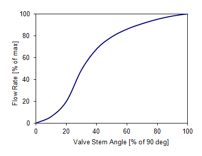

Of course you should check your TPS setting too. The flow increase from 3/4 to full opening on a butterfly valve is not very much but if your TPS is set on the high side, the extra TPS voltage could be making it run fat (rich) at WFO in which case you might lose a few rpm...
