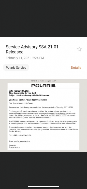

    Can’t believe nobody posted this here yet been on hcs for a week must be communication issue ?
    Anyway if your 850 starts hard when warm have the update done if not leave it alone . EE84F4D5-5834-4057-B620-EC8F257A0D8D.png

    Looks like its to address HOT START issues. I don't have that issue so I won't do the update but this is good information.
