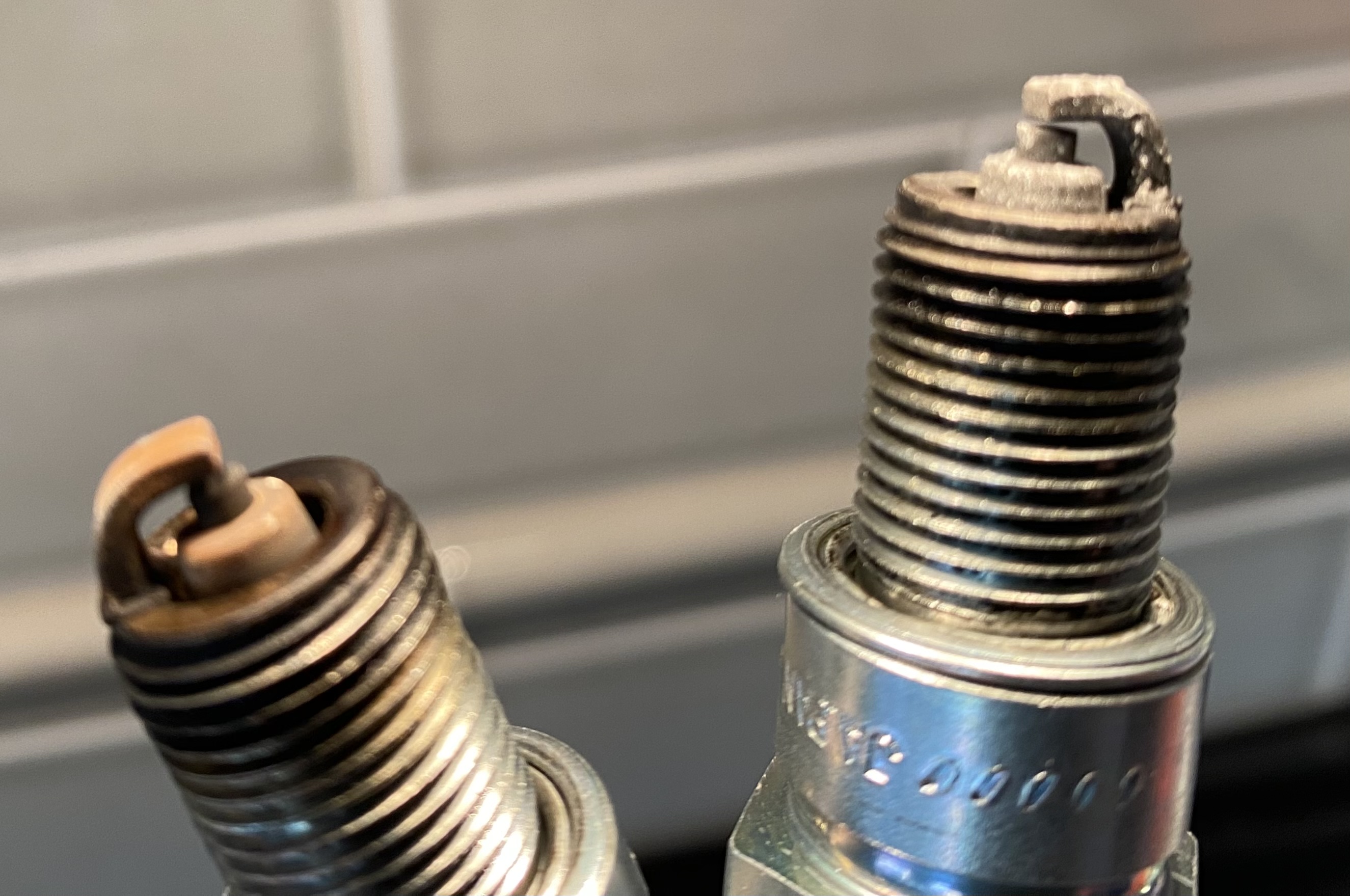

My 2023 polaris matrix 650 died at 81.6 miles, 3.7 engine hrs. Appears to be piston melt down, clutch side.
It’s at the dealer. Should know more this week. Hopefully polaris replaces what is needed……engine.

That left plug looks awfully clean for a sled still in break in mode.

Also have a new xc650 lost compression on mag side plug looked identical. The aluminum around the sleeve exited and dropped sleeve down. Day 5 and still waiting on Polaris to decide on what they r doing. This one only had 140 miles. Dealer says not the only one they have seen. Anyone else have issues?

Did they ever say what caused it to fail? Like I said above, that good plug looks awfully clean for a sled still geting extra break in oil.
Both of you need to check the oil line at the reservoir when you get your machines back, the fitting they are using on the oil tanks now is notorious for not bleeding correctly and there being a big air bubble right off the tank.

Mine was pdi correct and was not an oiling issue. They had casting issue with the aluminum is what the dealer is seeing. Polaris won't comment but there's been quite a few at this dealer..... the aluminum around the sleeve left in my engine.

Interesting, wonder if this caused by the magnesium shortage that was going on a year ago.

Well the dealer reported back. Polaris wants to repair just the top half of the engine.... I guess it doesn't matter that aluminum has went through the crank bearings too! Guessing I don't get a say in it. Spend good money to have a reliable product and they r gonna piece it together and hope for the best. I've tried customer service with no resolve and the dealer I purchased from has been to the polaris rep twice. What choice or route would you guys go?
