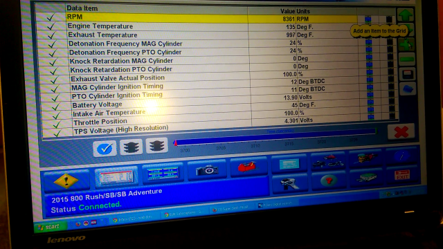

I decided to get it on the dyno to prove my findings I seen in the field. Exactly what I seen in the field showed on the dyno.We hooked up the digital wrench along with dyno to see what's going on. The digital wrench showed the values I put in,engine temp,exhaust temp,det frequency,knock retardation,exhaust valve actual position,ignition timing,intake air temp,throttle position and TPS voltage in high resolution. This is very helpful and handy to go along with dyno. Very important information.
