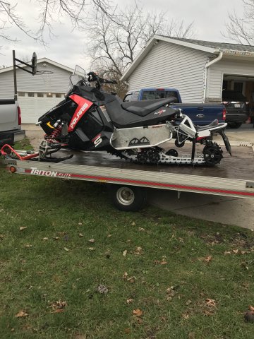

Will you guys have to run offset axles? Post some pics

thanks for posting the picture looks good
