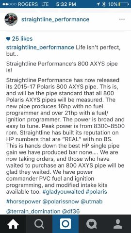

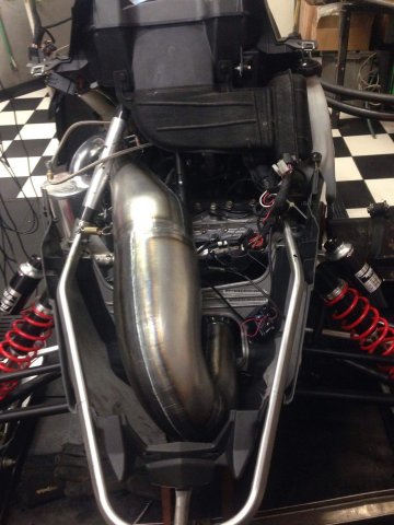

Well new Pipe dream numbers from straight line performance
16+ hp full system including y pipe without fuel controller needed
21+ with pcv with timing
The 16 hp is with Y pipe, Pipe, and muffler. They are claiming +3 hp with Y pipe. So 13 hp with pipe and silencer Wonder if Bikeman's Y pipe will also make that much.
A Y pipe would be an easy bolt on upgrade...
I'm skeptical about these gains.
I asked them to send a pipe to dtr so we can test
I'll wait for their reply
