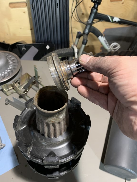

I have a 2016 Switchback 800 pro-s and on the last ride of the season I thought I snapped the drive chain as the machine stopped moving but both clutches and the brake caliper were spinning. I finally pulled the chain case cover last night and the chain and both sprockets are fine.
i started it up and gave some gas, when the clutches engage both sprockets are spinning but the track doesn't move, when i looked underneath everything looks fine and when i hit the gas you can see the track just barely starts to move and then stops even as the RPM's increase.
Anyone have any thoughts before I continue pulling it further apart?
Sounds like the lower drive shaft is sheared.

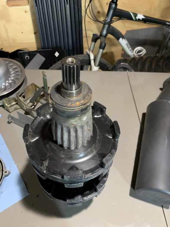

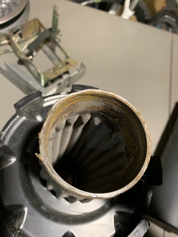

So the cap that is welded into the housing on the gear side of the driveshaft had broken the welds and was spinning in the housing! drive 1.jpg drive 2.jpg drive 3.jpg
Holy crap!! Thats crazy!! must have been some pretty shotty welds.

Just found this site. I have a 2013 800 Pro RMK that we have broken the shaft 3 times. Once it failed in the similar manner that your pictures show, and 2 times where the aluminum casting shaft spins inside the idler bearing and wears the shaft down like a pencil in a matter of 100 miles. I don't have pictures at this time. I will try to take some as we work to repair/replace the shaft for the 4th time.
