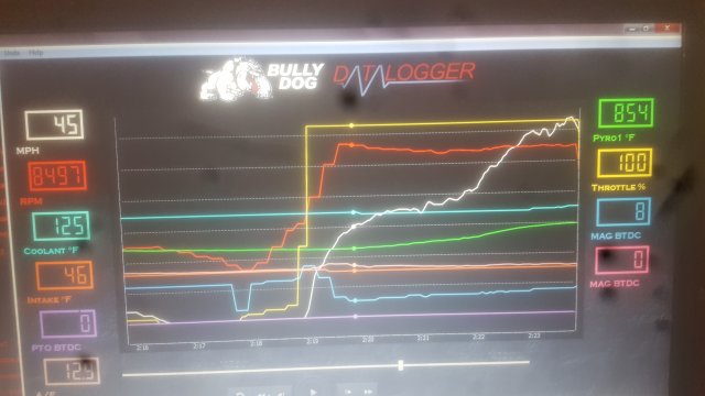

What about data log. I understand that you have to go on their web site dowload your map their to be able to see what is hapening in your sled ???
wtf is that ????
just to see what you log ??
You just download the software to view to datalog? Have you ever datalogged before? Its the same with most softwares. I have several different ones i use on my turbo cars. Works awesome for dialing in clutching in a 2 stroke because you can record up to 20 mins per log.
You can see anything in the ecu. You pick. Air fuel, rpm, intake temp, knock, timing, injector pulse, coolant, rpm, boost, etc
how many parameter can you record at the same time ?
can you see what setting they have put in their map like oil pump etc
can you see what the mapping looks like ( richer or poorer, advance etc)

You can do 8 different sensors for recording at a time i think. No you cant see any of the maps but they change it and i swear my life on it. Ive been to the shop and tested there and watch neal adjust my maps himself so i know they are doing what they say. And my sled uses alittle more oil now so i know its injecting more. Its not really a big deal that you cant mess with rhe tuning. Do a couple data logs and if something is off send it in and we will look at and send you a new map asap and 5 mins you are out riding again. But they every stage tune pretty dialed in now after 3 seasons of testing. If you seen all the maps in the ecu you would double think it. Its not like a bike or car. Theres a map for every power valve stage puls altitude and corrction maps and more. Its very complex. I have well over 2k in aem and hondata software to tune my turbo racecar and its less complex then the polaris map and i have 2 different cam profile maps plus boost in that car all at once.
Bully dog controls who can adjust maps. Only dealers only. SLP cant give you the software to make your own maps either. Talk to bully dog about that. Its not bmps call.
Yes if you have afr like i do you can see if its rich or lean in whatever rpm. You can see timing advance and retard and knock as well

You need the bullydog docking station. It comes with the O2 sesnor you need. Thats the only one that will work with the bully dog so you can see it on datalogging. There are others but they are a seprate gauge and wont show up on datalogging.
