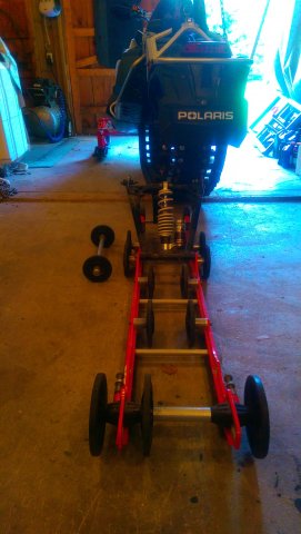

checking suspension
I'm just doing some maintenance checking and going over. Found two chunked wheels and 5 bearings gone. 2250 hard miles in snirt ,snow,ice, rocks and roads. Huge punishment. Warranty time :)

back in the xcsp and the iq(Dragon) chasis with the full plastic 5" wheels it was worse for delaminating rubber from idler wheels.
These new light weight wheels don't seem to bad in my opinion.
Guys with improper torque on studs is causing wheel failure from what I've seen.
I have studs also. Two wheels chunked for the abuse I put it through ain't bad .Dunno
I wasn't in really to many low snow conditions this last year. And I had wheels and bearings changed on warranty as well.?.?. I only have 2040 miles. Hard miles, but most in great snow conditions. I guess they might have to take a look at that. Or I guess I'll just get new wheels every 1500 miles..lol...

The warrantied mine. In fact the dealer is the one that actually noticed the wheels and bearings. Then they were the ones that ordered them and got them and put them on without even telling me until I picked them up. Maybe I got lucky! Hopefully it doesn't happen again then. Cause they won't warranty them again, I'm sure... Do you guys notice a lot of chipping of the paint on your springs?? I guess there was just a ton of chips out of my FTS too, they also replaced that as well. And I looked at my wife's and hers had chips out of her front track shock springs, but not to bad. So I wonder how bad mine could of been for them to replace mine and not hers?? I didn't really look at mine before I dropped them off for the updates...

The idler wheels delaminating could be poor from factory. And I could have abused them also with my studs. I'm willing to replace the 2 wheels at my cost. Not the 5 bearings though.

I do have an awesome dealer!! And the bearings are what cost the money anyway... And I don't have studs and it was doing the same thing. But like the spring I never seen the wheels either. But I looked at my wife's today. And they all look great and all the bearings seamed to be good. So I don't get it??
The bearing was tight on the bad wheel also. If the wheels chunk again I will go to a solid, possibly aftermarket. Anyone know the diameter? I have correct new bearings if needed, forgot the number though. 6004?
