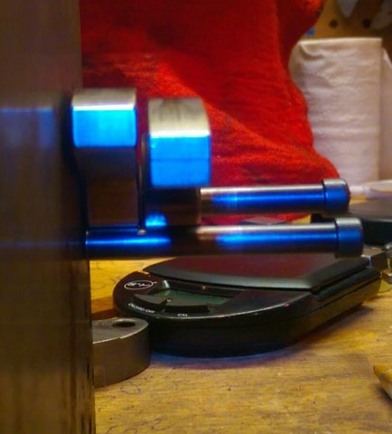

Since I have a jig in my shop to check weight profiles,heels,tucked,,pin placement,etc.....
My jig simulates the way the heel sits in clutch.
these are both belly buster 70 gram weights. The one on the left is the newer version, the right is 10 + years old. The heel and pin placement(which you can't see) is exactly the same. The profile has changed drastically. The newer one is less aggressive, and the older version is very aggressive. I don't remember EPI saying they changed the belly buster weight profile????

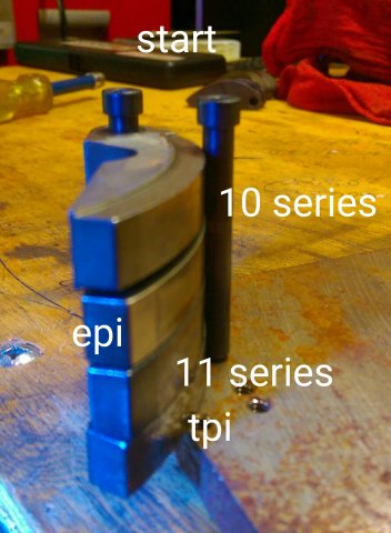

newer belly buster on left, 10 series, and older belly buster on far right. All 70 gram weights.
the new belly buster has a less aggressive curve then the 10 series. All these weights have the same heel and pin placement(which you can't see)
The slp weights definitely look heavier in the heel, mid and tip vs 10 series. That will pinch better then the 10 series for sure and pinch harder up top too.
I've tried everything but slp weights. Might have to try them. I like heavy heel, mid and tip. Something the 10 series lacks is tip weight. Weld .5 of a gram on tip of 10 series and they pinch better up top :D:D

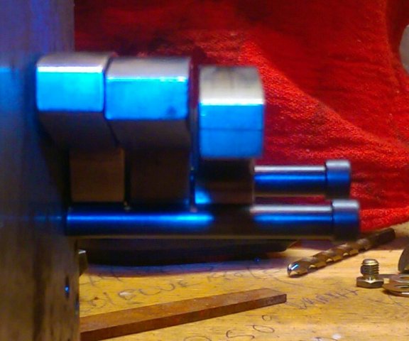

heavy hitters are at the bottom. My jig duplicates roller on spider. The heavy hitters are the most aggressive profile in that bunch, also a ton of heel weight.
10 and 11 series have almost the same profile, but different heels, mid and tip weight.
