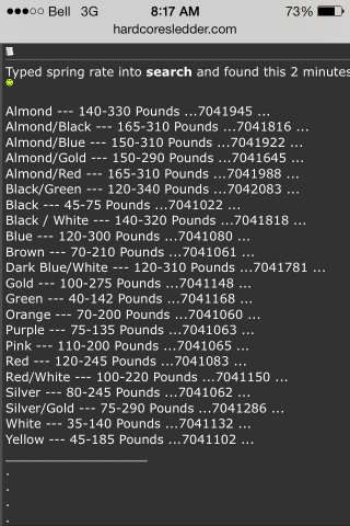

I have searched - and nothing.
Just want to know where the stock Polaris ones are at verses the ones i am going to replace mine with...for reference ??

Are you looking for a chart with all the springs listed with their rates? If so here it is!

Nevermind. Cut and paste from another helpful site:
Drive Clutch Springs:
PART# COLOR DIA. LENGTH 2.50-1.19" Lb/inch
7043121 Black 3121 .255 3.05 100-340 183
7041781 Dk Blue/White .225 3.42 120-310 145
7042083 Black/Green .218 3.38 120-340 168
7041818 Black/White .218 3.52 140-320 137
7043342 Black 3342 .218 3.46 140-330 145
7041945 Almond .218 3.65 140-330 145
7041922 Almond/Blue .218 3.75 150-310 122
7041988 Almond/Red .207 4.27 165-310 110
7041816 Almond/Black .200 3.75 165-310 111
