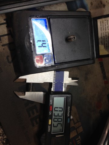

Here is the weight of a CPC set screw and length, I think there is one shorter set screw

AFM, do you know what the 6 different sized set screws each weighed?
I have the weights right here for you Dave.
1/4 inch=.7 grams
3/8 inch=1.3 grams
1/2 inch=1.9 grams
5/8 inch =2.5 grams
3/4 inch=3.1 grams
1 inch=4.3 grams
In the instructions Dalton recommends not using the 1 inch screw as the FIRST one in to the base weight OR use the 1 inch by itself bottomed out. Minor distortion during the heat treatment process can make the threads in the base weight very sensitive to binding and this 1 inch long one could jam in the threads making it NON-removable if all of the way to the tip. When using these weights in previous sleds that I've owned Ive used really soft primary springs like the 110-290 with lots of weight at the heel with great success as the belt is really pinched harder in the inefficient part of the primary giving me way better hole shot and midrange. I'll be trying my QAP-3 weights with a P2 secondary as I made huge gains with my 2011 Rush.
