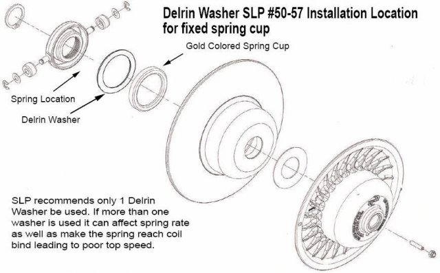

Anyone know where the washers go? I have a 3 pack and I'm doing my new spring and helix in my secondary but not sure where these go...
You will get pro's and cons on this, I have always used 3 delrins. 1 in the spyder and 1 on each side of the cup.
I have also seen guy's make these out of a plastic oil bottle and they worked fine.
I put one in spring cup.
If you add all 3 your changing the rate of your spring .
Ya it only shows to add one cuz adding more it changes the rate and can cuz the spring to bind or something.
That's a heck of a good idea. Div20
Never say never, but I have never seen a Team secondary with a fixed cup.
