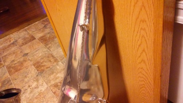

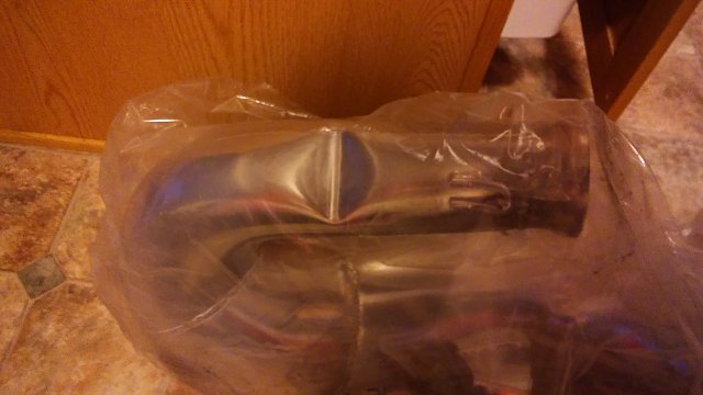

I purchased ceramic pipe secondhand with very little use. I received it in mail and its got two good size dents in it. Will the dents mess with performance? Im attaching pictures.
Test fit it. They might be there on purpose for clearance issues in the chassis. If they're obviously not supposed to be there, email Joey or Neal at bikeman and they'll let you know.
They are dented before ceramic coating because the pipe itself is a bigger volume pipe so it needs the dents to fit correctly. There is no performance loss with the pipe like that.
