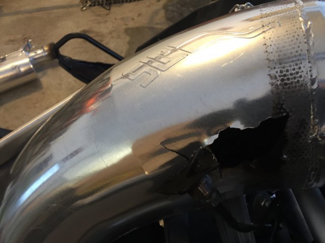

Ummmm--Could the intermittent engine light have something to do with THIS manifesting? I saw a giant crack and I finished tearing the hole open when I tried to unscrew the exhaust sensor this morning. Sled wouldn't start at all today with the crack. I had RIPPED the last few miles home yesterday and shut it down--no issues.
It wouldn't start this morning. So I replaced the pipe/can with stock once I saw the damage--and removed resister--replaced wet-fouled plugs and still no start. Irony--I was going to move the harmonic strap today per SLP recommendations. Too late.

.View attachment 932
Jesus that really blew a hole , probably just flooded really good , leave the plugs out over night to let it dry out ....
