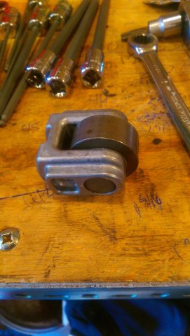

also, this chain tensioner is less restrictive.
That's like the tensioner they always used,not a fan of this new slider one I think I'm swapping mine out
Yes the roller part was used on TX's etc from the 70's through the 2,000's.
If you get this chain tensioner. Lube it very well with chaincase oil before installing. If you don't,it will take a bit for oil to get up there and it will make a bad whining sound.

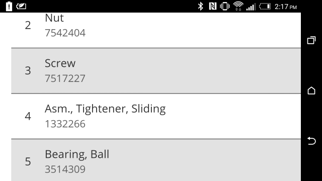

Brock I am guessing you show the nut bolt and bearing above just because that is how you copied it, not because you need those also to use the IQR tensioner?

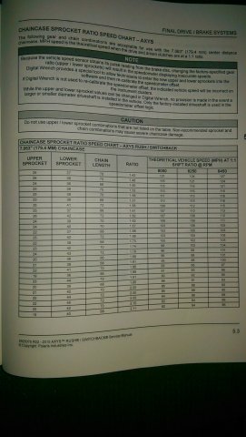

I just came back and read this. Is the 22/38 a accepted combo on the Axys gear chart or just one that fits? Less dog leg I like with only a .012 difference in ratio

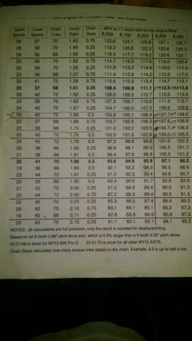

Does anyone have a pic of the 22-38 gearing and the 23-40 gearing in the chaincase? I'd like to see the lesser dogleg of the 22-38. I am about to order a gear and chain for one of these setups. I have a 40 gear and a 22 gear. No 23 or 38 and neither chain. Leaning towards the 22-38 because of the lesser dogleg and the slightly lesser weight of smaller gears and shorter chain can't hurt, but theory is bigger gears are more efficient. Thoughts anyone?
Does anyone have a pic of the 22-38 gearing and the 23-40 gearing in the chaincase? I'd like to see the lesser dogleg of the 22-38. I am about to order a gear and chain for one of these setups. I have a 40 gear and a 22 gear. No 23 or 38 and neither chain. Leaning towards the 22-38 because of the lesser dogleg, but theory is bigger gears are more efficient. Thoughts anyone?
I just put the 23/40 and 70 pitch chain in my pro s 800 and the dog leg isn't bad at all,no pictures and its back together now sorry
