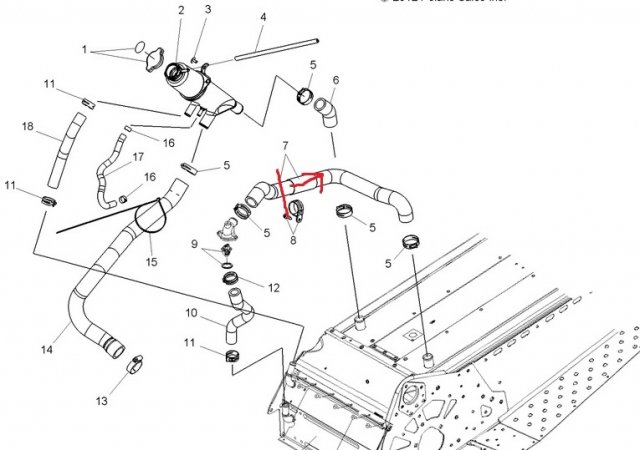

Have to figure out where to plumb in for the coolant cart!
Might be more work than I wanna get into, but I built it to race!
Pull the t stat for the cool down cart. Pull the front limiter up tight to start. Use chisels.
Already have the T-Stat pulled. And the track I will be checking out I am Pretty sure it's equipped with chisels.
Main concern is where to tap into on the INDY for the cool down cart.
This is what I would do. Cut the hose so the cold water is pushing into the coolers first. That will gradually cool the motor by pushing the cold water in through the hot, before it hits the motor. Run straight water. Too bad you aren't close to Illinois. You could use my old cooldown cart. I retired it in 96
I will have to look at that hose when I get home from work on the 18th. I think it might be hard to get at behind the chaincase but I don't see any other options as I looked at that diagram.
EDIT: just realized that's the main hose from the T-Stat. Housing. Shouldn't be too bad to have access to!
Yep, I agree , was gonna post the same diagram.
