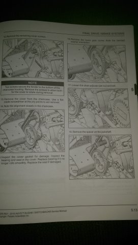

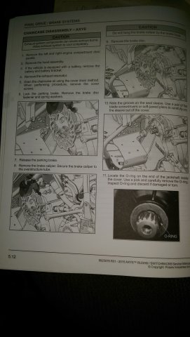

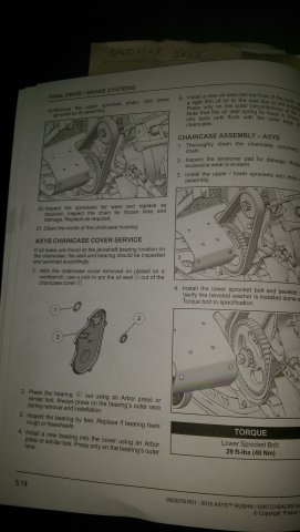

thank you very much , i just receive and install my new cutler ramp but....
i find that my jack shaft bearing is destroy....
now if somebody can let me know how i can remove the chain case cover
i'll be good to replace my bearing and continue set up
