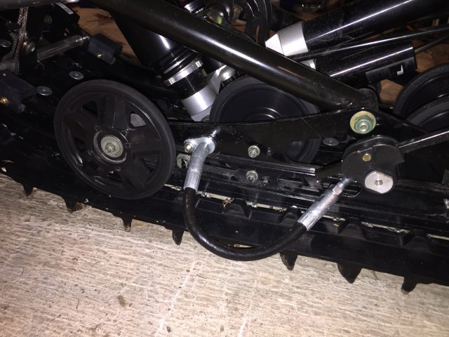

Good morning.
Does somebody as intall Ice scratcher on a Rush (120)
I use normaly Trail Blizzer ( flexible scratcher) on my rmk Switchback and 129 AC
But on the Rush i can't find a place to fit them on this short skid, wiout beeing
in contact with tunel when not in use ( the loop that it makes comes in contact with the inside of tunel when suspension compress. Is it possible to pu that inside of ski ?
does Plastic ski tuff enougnt to put that there ?
will it be as efficient as on tunel ?
If you have some pick of what you have done i'll apreciate
https://www.qualipieces.com/fr-CA/t...rderBy:null&IsDescOrder:false&Index:0&Count:0
Regard's
Pierre

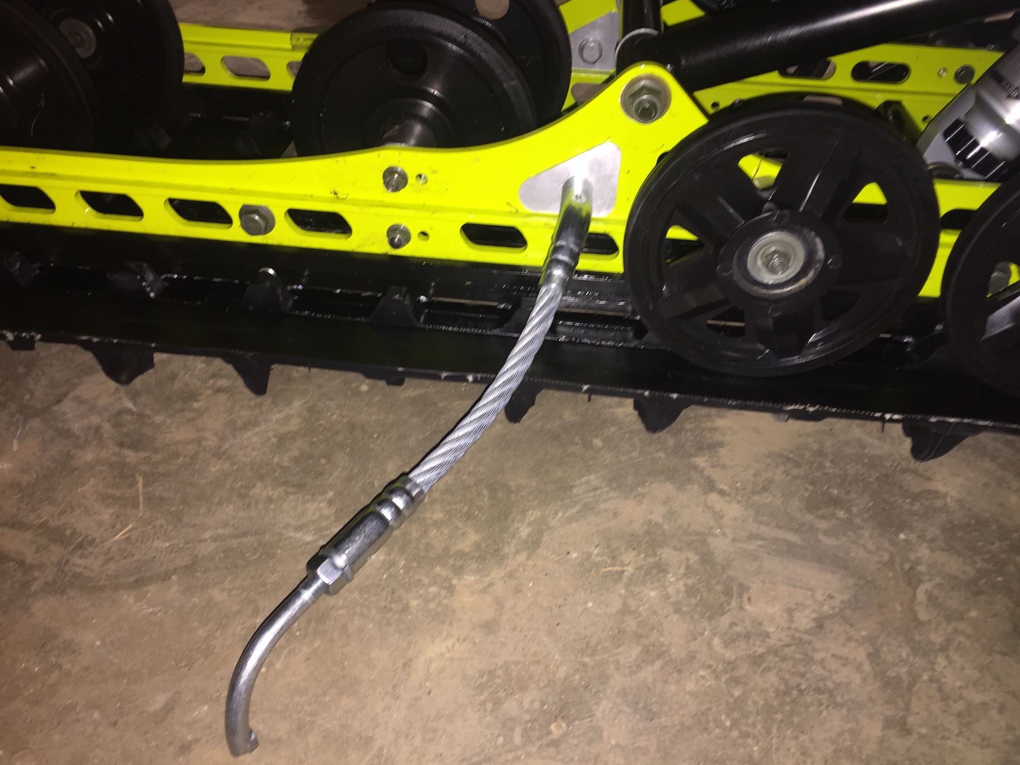

This is were I installed them on my assault
I'm thinking your wheels are in the way?? Mine are inside the rails. Can you put the second wheels inside and install trail blizzards ???
That's exactly my Problem ( the wheels are in the way) i will check if i can put one set Inside if so it will woks great.
Don't know why i have not think about that my self ( dick head) :)
thank you Brock
Just try to switch the wheel inside, but i don't have the space to fit it.
It doesn't clear the front swingarm...
Any other sugestion ?
120 inch is very short to fit a scratcher ,,,, no space left
I have have them install like that on my switchback too, but on the Rush if you install them at this location, it won't do any good, way too much on the rear,
ice wont catch the rear radiator. remember a Rush is 17 inch shorter than a switchback
The track is 17 inches longer but the actual length is only half of that. The usable snow chunks the scratcher sprays are the ones sprayed sideways onto the rails. I wouldn't think it would be much more different than a SB. Without scratchers my 800 was running 140s and getting into the low 150s degrees. With them down it never got out of the 120s. And this was a 40 degree day with icy trails without much snow on top. I don't think there is any other places to mount them on these rails without removing any outer bogeys
if i install them their, the tip will be only 13 inch before the end of the rear pad, i doute that it will have an effect for my cooling.
i know that they work , if the snow/ice spray is coming from the front of the skid but so much at the rear ???
When the scratchers throw the snow/ice between the rails, the spinning track throws it everywhere, including into the heat exchangers. The scratchers don't directly spray the heat exchangers very much. It's all about blasting the track with snow chunks so it throws them everywhere.
