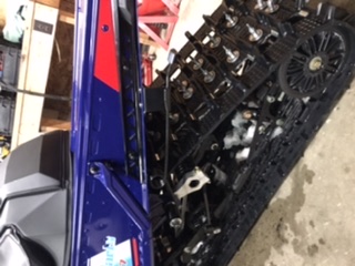

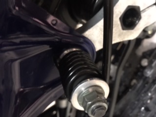

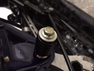

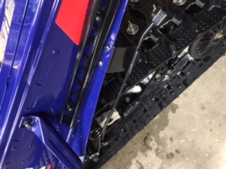

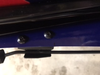

I have the new 2020 indy 600 137 anniversary edition and i mounted the skidoo tunnel mounted scratchers with replacable tips. I had them on my skidoo renegade. They work awsome and you can back up no problem. Nice clean install. Needed to get a 10mmx4 1/4 inch bolt to use the factory nylock nut. The bolt with the kit is 4 inches but not quite long enough. If you want pics send me your info and i will e mail them to you

My skidoo scratchers. Work awsome
