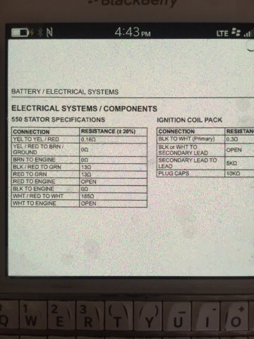

Having spark issues. Here's what I got with my multimeter compare to what they should be. Looks to me like stator is faulty. What you guys figure. Coil is within spec from black wire to white wire but at 15.2 from plug to plug, spec says 10kohms. I don't know if that's to far out of spec or not. Any info will be helpful. Thanx.
