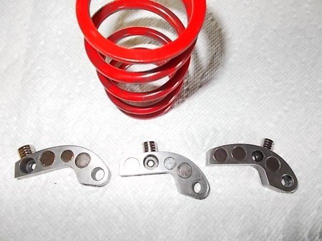

Indy Dans adjustable mag weights

He sells these on ebay. Notice the 2nd hole counting from the pivot uses a smaller magnet.
I like that.
Yes I noticed that too.
This area doesn't need huge weight and he sees that. Just the heel and tip in my opinion.
I wonder what the profile curve is like compared to 10 series. More aggressive, less aggressive???
Also, is the heel tucked???
Also the magnet holes are on the opposite side of the weight ( SSI ,Bikeman, ) I'm sure to get around patent rights.
http://www.mdsclutching.com/#products
Check out MDS weights in above link, heavy heel, adjustable tip , more aggressive than a 10 profile.
RD , magnets on one side at 12 noon and other side at 6 o'clock.
But in my mind rotation is always pushing the magnets against the weight. In reverse it would be the opposite? Stroker2 are you one of the old Porker Run guys?
I just bought a balanced clutch off Dan for my pro r 800 and he sent me an updated set of weights and the last hole uses the small magnets the first set of weights looked like the picture posted racer Dave
