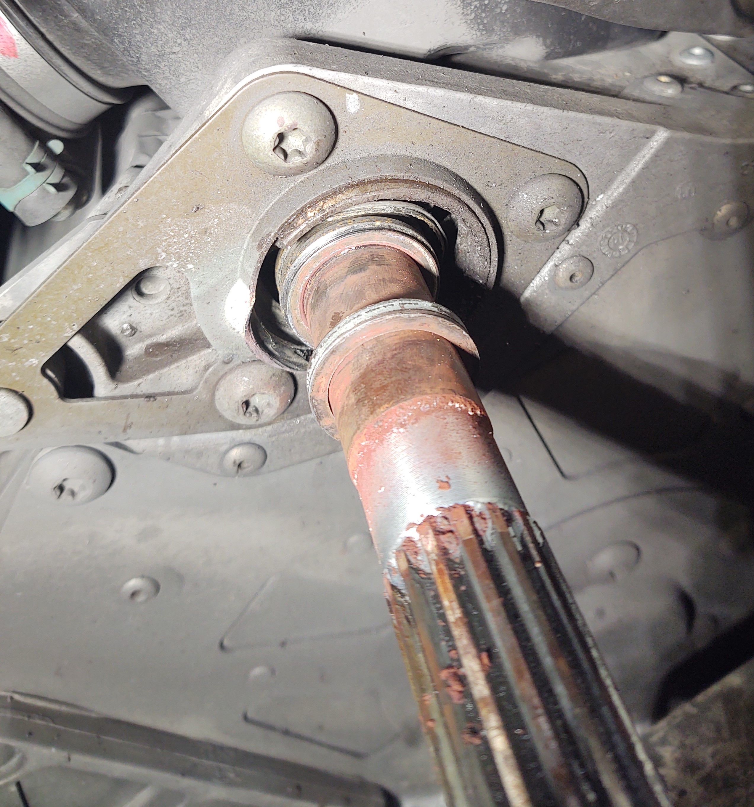

Has anyone had any issues with the jackshaft bearing on the axys or did I just get a bad one? only made it to 2300 miles, completely blown out while on a trip up north. Anyone try modifying these to use a grease fitting? Or a better aftermarket bearing? Hate having to go home early!

Totally gone, 5,800 miles but looking for better method on keeping them greased.
