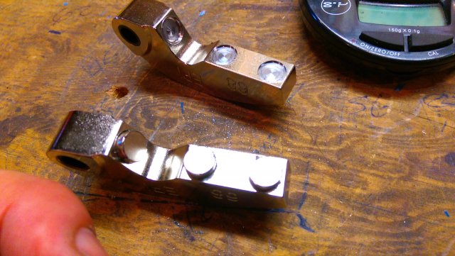

Made a set of adjustable weights
I used a set of 68 gram epi's . I have 1.1 gram magnets to use(very very strong).
I got my buddy to machine these. The holes are recessed 0.025" to accept magnets(just enough to hold in place)
The base weight with 3 holes recessed are now 67 grams. Now I can add 1.1 gram of weight in the heel,mid or tip. This is easy to adjust on trail.
I'm trying them this winter.:DRockon

Bikeman is doing it. They say they hold no problem, we'll see???
I tried this on a set of weights I don't use. I'm gonna test them this winter and see what happens. If the magnets fall out. I'll fill the holes with welds again and grind to 68 gram as they were.

I have to use a small precision screw driver to remove the magnets. There strong.
I'm going to try what I've done. If it works, I'll be happy. If not. I'll fill the holes with weld again and grind smooth. No biggie

The magnets are 0.120" thick. If I was to take out that much material from the weight itself, I would replace it with a magnet and be basically at the same weight again?? I just don't see the point in that. I get what your saying though.
The only weigh that would work for me is to start with a heavier base weight.
The recessed holes are just to keep magnets in place(no sliding)

These did not work. Magnets need to be on the side
Curious what problem they have?
The magnets didn’t hold to the underside. Didn’t take long either
Needs to be on thrust or trail side of weight .
Oh well. Just an experiment
