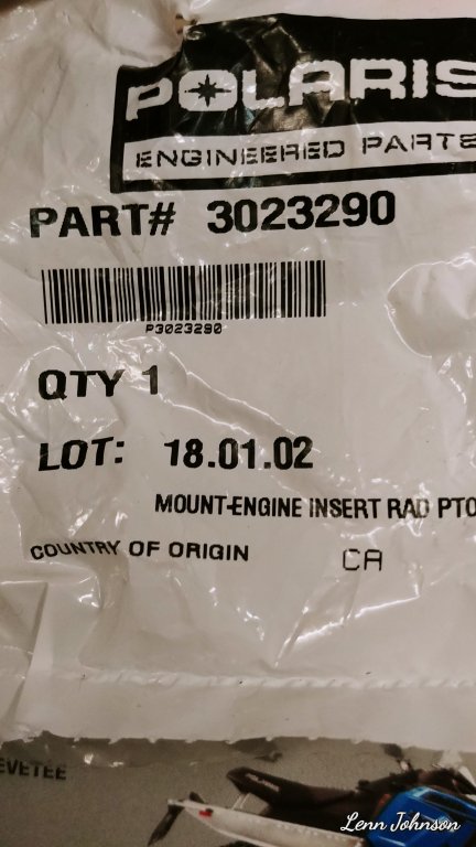

I haven't ordered yet, the 18's are the ones to order, 4 = PTO SIDE FOR 2018 PART #3023290, correct?

Here's the correct part number.

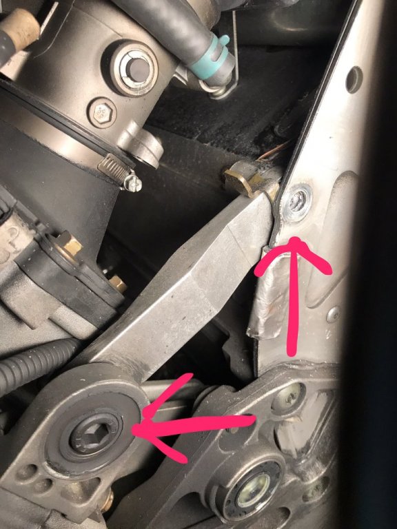

Has anyone ever checked or had these motor mounts fail out prematurely too?

We have 2 assaults in our group
one broke like that lost all the rivets at the start of the season just checked the second assault that has half the mileage on it two rivets gone and broken torque stop hopefully Polaris is going to do something about this
seems to be happening only on the assaults haven't seen this happen on the switchback yet if you dont catch it in time it wiĺl do big damage and you will need to replace the tunnel big dollar repair both in our group caught it just in time thank goodness for warranty
check those rivet boys
That was just a picture I found on the Net, and ya heard guys having issues. I’ll definitely be checking mine before I put it away for summer!! While mine is still on warrenty, ya $5,500 for that tunnel touch isn’t nice!!:mad:
If you Snowchecked it then you only pay $50.00. My warranty is good til 2020. Apparently the 2019 Assaults have threaded fasteners.
Was a non-current snow check, and apparently Polaris doesn’t allow the warranty to carry over if the original buyer backs out... bunch of BS!
