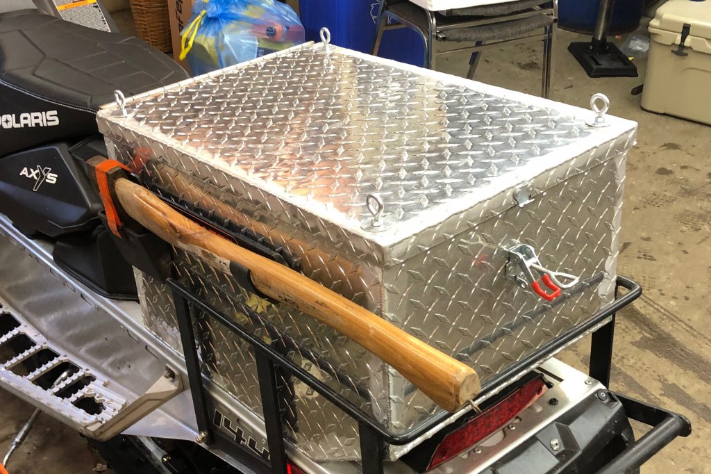

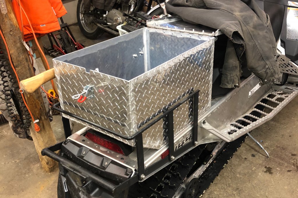

I agree, it’s rare but depending on ice condition slush can happen. I probably only tow a sleigh 5-10% of the time. And I’ve never had an issue with the stock gearing(23/40, 1.74). I built a box last year that’s been able to haul all my ice fishing gear on the tunnel for a more “lightweight” setup.
