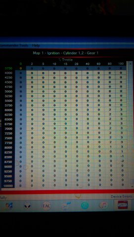

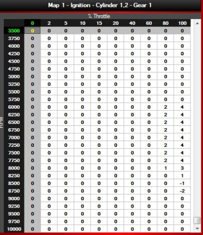

i was going to take timing out of the 80% column all together and change everything from the 100% column to 2 degrees but i ran out of time. it worked of the dyno with 2 degrees timing and didn't throw any codes

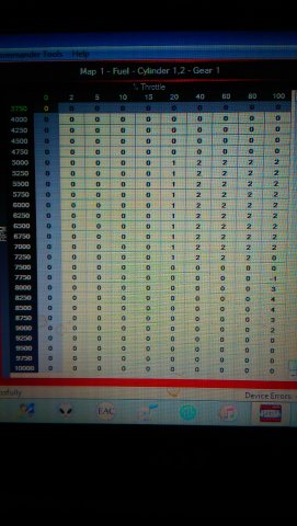

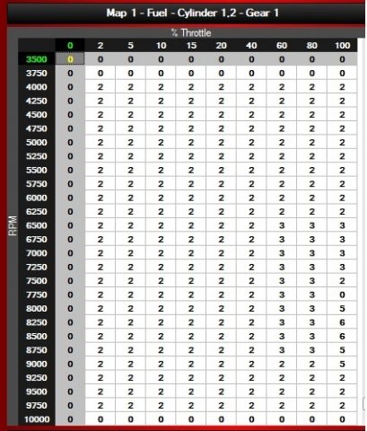

my 16 gets codes with 2 deg of timing. SSI sent me a new map with +2 fuel added all over and more in 100% areas but still 4 deg of timing added wonder if it will work. It runs too awesome (when no DET) with timing don't want to take out all the timing that would be a bummer! Hope someone can make a map that has the magic combination of fuel and power that gets power with no DET

I don't know what else you were using with the 2 degree timing??? fuel??? timing??? in what areas??? just because you had 2 degrees timing doesn't mean that was at fault cory, way to many things going on.
And that fuel map that you pictured is way to much fuel in some spots and would kill the hp and torque. If i put that fuel map on the dyno, i gaurantee it woud be down on hp and torque a lot. You mine as well not have a pcv and just run the pipe????

That's the map Eric from ssi sent me last week he is sending to guys that are having det problems. Yea it's rich. And yes stock might run better then this maybe not with the timing and you have told me yourself these things love fuel
The one I'm running 2 deg timing on is the heath map modded with fuel how you told me to do it with 2s added in the mod range of fuel map. 60-80% throttle. Taking off the pcv completely and leaving pipe makes it det worst than the original map on my sled anyway.

I'm more than frustrated to tell you the truth. Don't mean to be an ass. Thanks for the help Brock I will try taking the timing off dtr map still should run better than stock
CORY, THAT TIMING MAP IS THE ONE WE BUILT AT DTR. CHANGE ALL THE 4 TO 2 AND 3 A 1.AND THE TIMING IS NOT MAKING IT DET UNLESS YOU ARE IN THOSE COLUMNS.WHAT FUEL MODE DID HE SAY TO RUN IT IN I DIDENT NOTICE?

So this is not a timing issue, this is lean part throttle problem. Just for shits and giggles and 1 or 2 % more in the 40-60% area between 6000 to 7500.
Cory, try this fuel and timing out. I had it just about right and no det with less fuel. I added more fuel and ran outta time to try this. I think it may work??.
