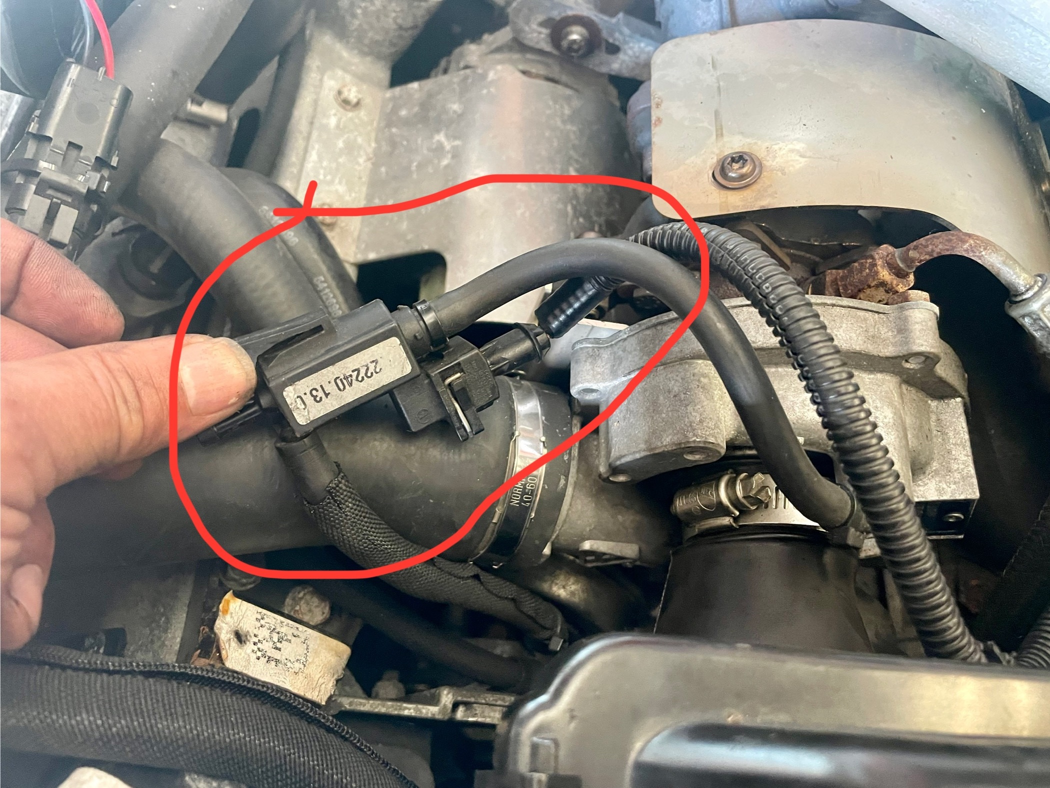

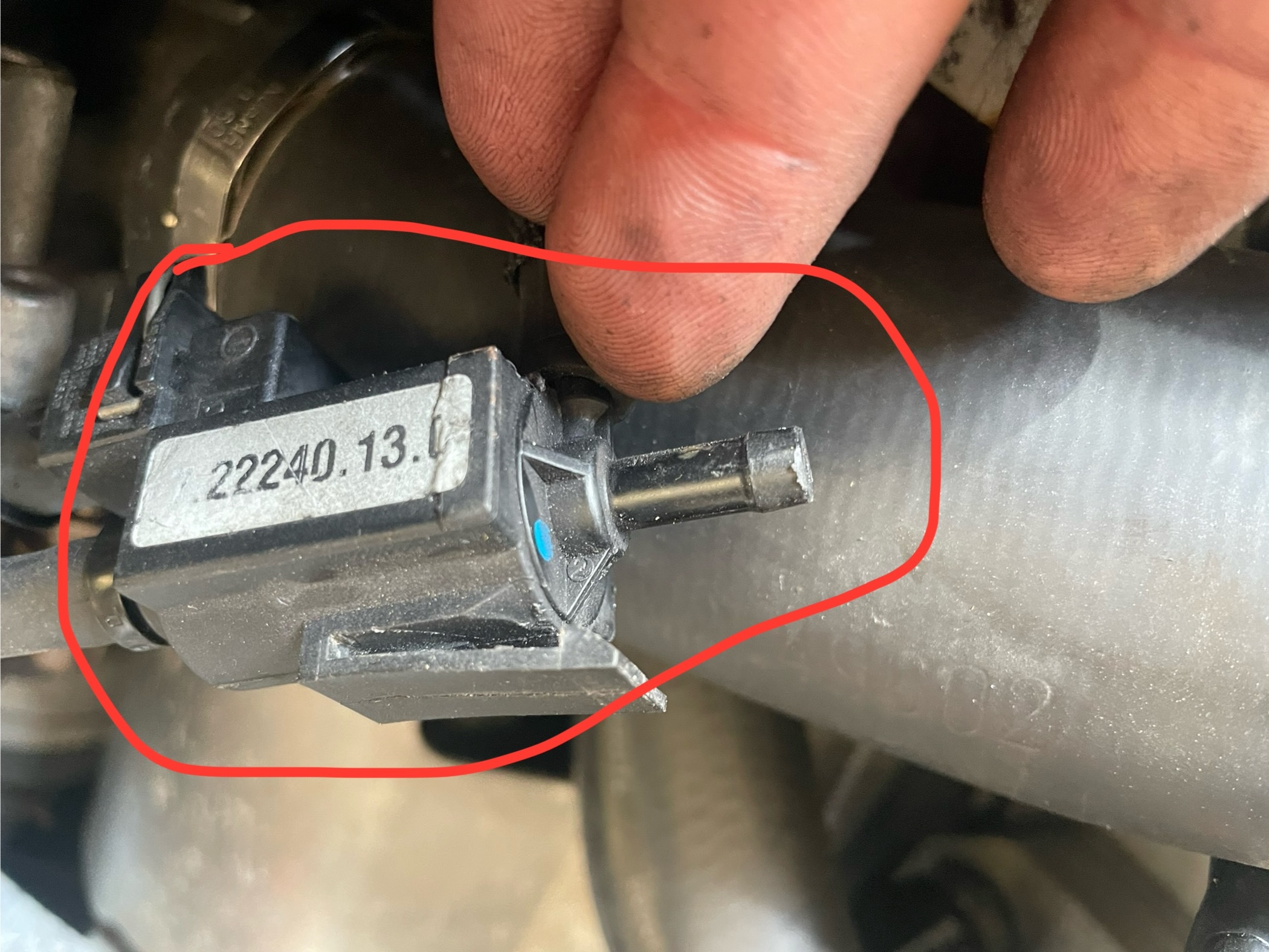

I always service my sleds annually, and try to do as much maintenance on my own so that I can learn and know exactly what has (and has not) been done. Recently I completed an oil change on the unit. As part of the oil change, I was required to remove the airbox in order to access the oil filter (boy that was a bugger to get the cover off). Once I reassembled everything, I found that there was a hanging part that I cannot identify where it should be properly mounted. Please see photo 1.
If I had to guess, it is a vacuum line of some type. It has a clip, but I cannot find anywhere to mount it so that it does not bounce around. Also, please note that one side has an end that appears to be for a hose to attach. I could not locate any (air or vacuum) hoses that would go to this. SO, my questions relating to this would be (1) where does it properly mount and (2) is there supposed to be a line connected to this part?

Well I never owned a FST but I can answer alot of this.
That item in the pics is the boost control solenoid, it has an open port to bleed off pressure to control the turbo waste gate. Common part on any turbo charged engine. Looks like Polaris mounted it below the air horn to the turbo inlet which wouldn't be fun to get at now, see the parts diagram in the link below. Probably just zip tie it to the coolant hose at this point.

That was an absolutely FANTASTIC reply! I really appreciate you taking the time to answer my questions. Your responses all seem reasonable and I will follow all of your advice. Again, I appreciate the time you spent providing the response!

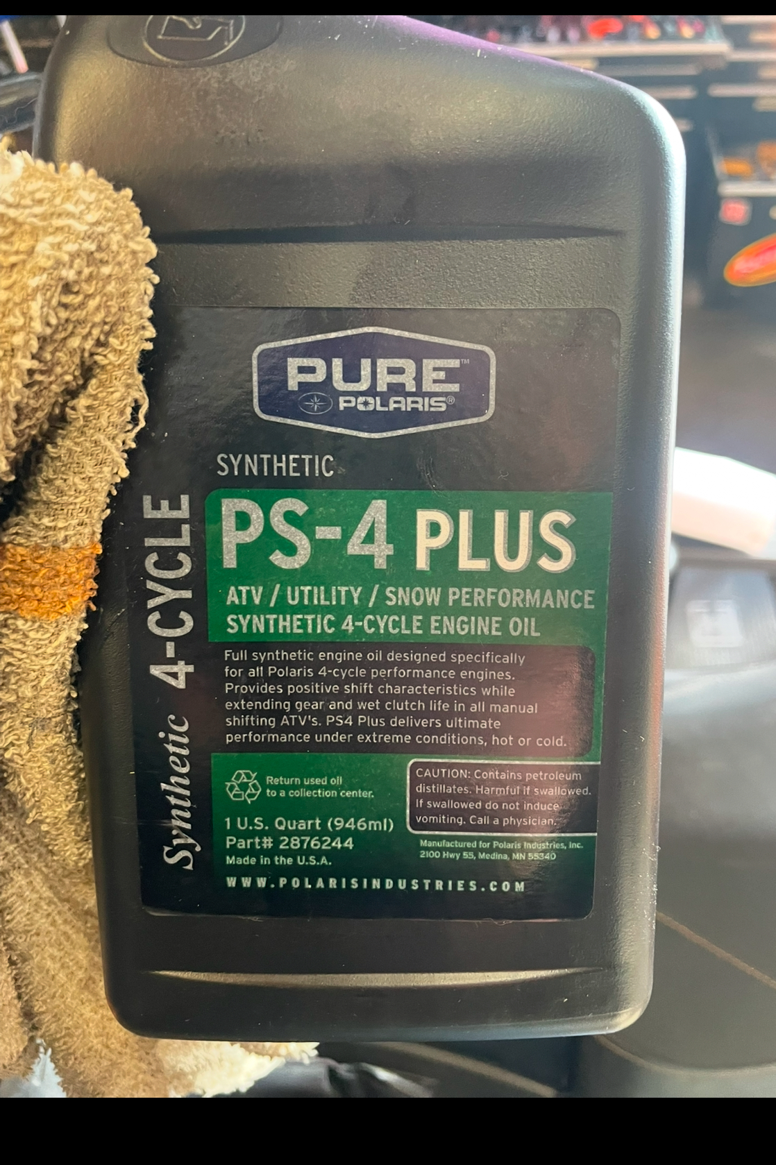

One more question please. When I did the oil change I was able to get a couple of the oil change kits (including jumper wire, filter and 3 quarts of oil). The oil that came with it was marked “Synthetic PS-4 Plus”. I want to buy a couple extra quarts to have around but the bottle does not show the viscosity/weight and it looks like this was another product discontinued by Polaris. Any idea on the current equivalent for this sled? Thanks!
