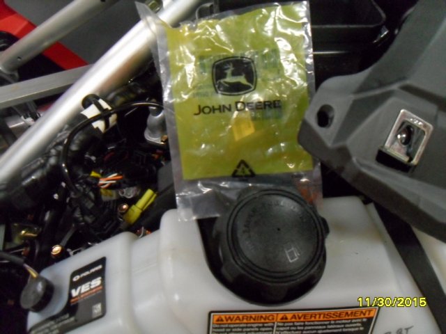

There is also a John Deere cap, used on fuel tanks, that also works. JD part # GX22166. The pic is on my 2015 Indy 600. works same on a AXYS.
http://www.amazon.com/John-Deere-Original-Equipment-GX22166/dp/B00CAXN8AY
One thing about this JD cap. If you r on the side or upside down. It will weep out. How much I can't say. Others and the guy that turned me on to this cap, say it is extremely minimal even if on it's side for extended length of time. Something to keep in mind, but unless you turn your sled over and leave it there I would not be concerned at all. I'm not.
