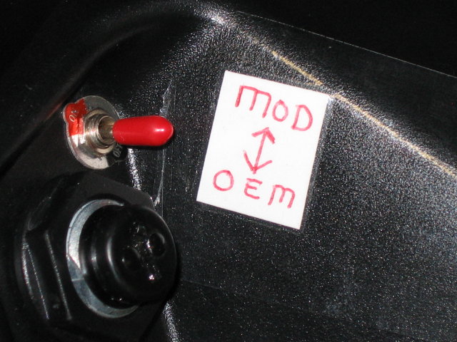

yeah, i hope there open tomorrow. been just waiting on the map from Jim. now is there a way to use the map switch so you can run pcv and switch off to run stock ecu ? Or do u always run pvc ?

Yeah, once the pcv is installed, you'll stay on that mapping until you remove the pcv (which you wont want to).
Yes you can use the map switch. You have the adjusted map from DTR or ? on position 1, on position 2 you can leave all 0 percentages at all rpm ranges , this will be the oem map. You can then flip between the 2 and see what is different in run quality. It doesn't matter which map you put in position 1 or 2. It can be either way. You can also run the modded DTR map in both positions, make changes as needed to one of them. Again that allows you to feel your improvement or mistakes.
https://i234.photobucket.com/albums/ee316/kawidave1/map_switchcrs-1.jpg
