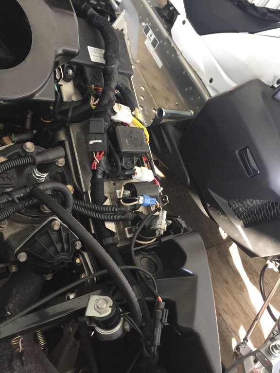

hmmmmmm can you help an old guy out ... not finding any fuses see photo
Underneath the clutch guard. Like right below the Blue plug/coils but underside of the guard. You wont see a fuse, it will be a Black capped fuse holder. There's a cluster of wires in there, just move them around and its in there. I cant remember 100% on that model sled as I haven't worked on one in a while, but if you want to snap a pic from the side we can make sure that cluster of wires is there. It could also be on the top there, maybe those red wires as it looks like the end of those are capped.

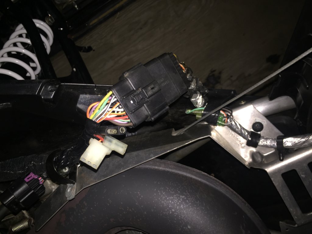

I went out again and pulled apart elect connections and have not found any fuses... I looked "under" the belt guard and dont see anything .. again its a 2011 IQ shift.. See attached photo.. there was a big wiring harness in front of the shock tower but I pulled it apart and its just wires..

Are you 100% sure in that cluster of wires by the shock tower there isn’t a wire that’s like dead ended and has a black cap on it? You have to pop the cap off to see the fuse.
That’s exactly where it’s at on all the 600/800 Pro Rode and AXYS Chassis sleds.
I am sure you are frustrated as it’s getting to be the same for me cause there is a fuse there somewhere!

It’s a mini style 2amp fuse but like I said it’s enclosed. Look for a wire that’s dead ended by a Black cap and has a clip you press to pop the cap off.
Post a pic of the wires all
Separated by the shock tower.

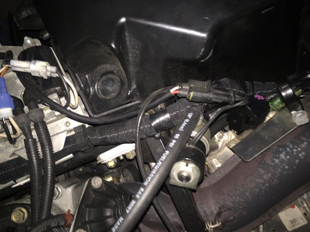

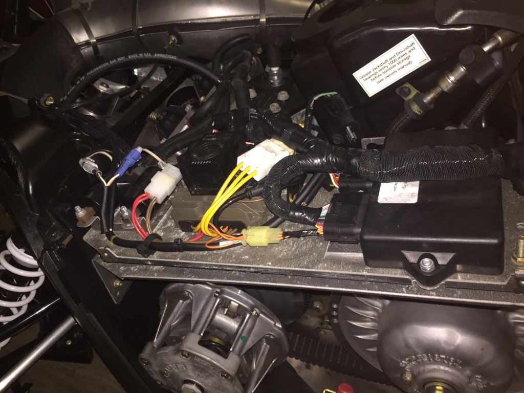

the big wiring harness is up by the pipe in front of the shock tower ... the other photos shows a "diagostic port"

would you happen to have a photo of this fuse dead end wire on one of your sleds?
Pop that cap off with the purple clip on it. See if that’s it.
I am away working until next week so sorry I can’t get a pic of the fuse holder.
that was the diagonstic plug in... on the cap is says diagonostic.. and I took the cap off and no fuse
